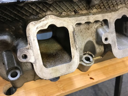

I have a set of 09+ eagle 5.7 heads on my bench waiting to go on my motor. The intake port is a lot smoother then the older 5.7 heads I polished, but the exhaust port can use a lot of work. From what I’ve heard the exhaust ports are somewhat smaller then the should be because of the MDS system they were designed to run for, I think some good gains have been made by opening it up. @ric3xrt has some good knowledge on them. But I just ordered a polishing kit, I can upload some pictures when I get a port polished. To answer a previous post, I’ve seen testing that showed eagles flowed about 330 cfm at .600, pretty much the same as the 6.1 heads. Here is a picture of the eagle intake and exhaust port 46d6b5fb733b556b73bcfb798aefc881.jpg
And a picture of how much rougher the intake side was on the early heads
