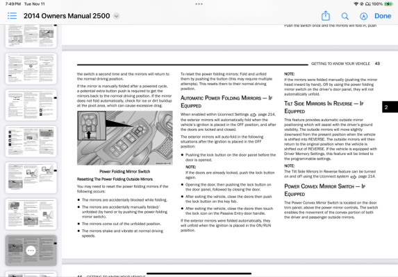

Here’s the pertinent page from the Owner’s Manual on Power Folding Mirrors: (no problem manually folding them…they just have to be reset by using the button twice)
