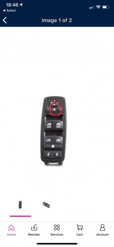

Also your best best would be to take your door panels off and get the PN off both door modules and post here or do your own research to confirm exactly what features they support.
Also you might need a mater switch swap because your current driver side window/lock switch does not have the power fold button. You will need to pull the switch out of the door to see what door switch you need. It’s either a 2 harness switch or a 1 harness switch.
Looking at your door switch if it looks like below you already have it. If it’s missing the button in between the mirror selection you don’t have the correct switch
I’ll get the part numbers on the door modules, if I ever get my truck back from the dealer. I PM’ed MPGrimm to see if he sells a harness. I already have the door switch.
Thank you for the part numbers on those mirrors, that’s what I was looking for!

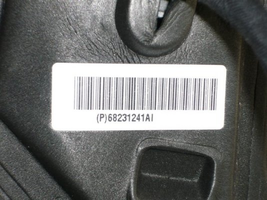

Thanks Mike. Looks the regular power fold/no color/no memory Pass Mirror got a new PN for your factory 2017 and 68263849 is apparently a pergola passenger side mirror w/o the AutoDim feature!
(R) Pass Mirror: 68231240AD
(L) Drvr Mirror: 68231241AI
.... Alt/superceded: 68338373AE (Ricks Ram)

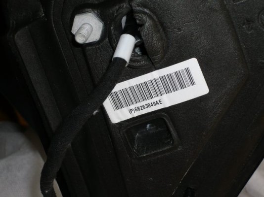

Thanks Mike. Looks the regular power fold/no color/no memory Pass Mirror got a new PN for your factory 2017.
Alt/superceded: 68263849 (per mjf6175)
M² Mods.
Keep in mind my OEM mirrors were also heated and auto dim as well, but like you said they were non-painted, textured black plastic.
