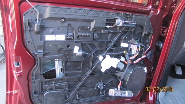

You said the truck is a keyless entry & go
when the vehicle is set to On, or even in Run position
does the drivers door Master Switch, lock/unlock work every time ?
It almost sounds like you have a bent metal locking rod, but i think that would malfunction 9 out of 10 times
It happened to my 2016 Ram passenger front door, it was bent when they were removing the door panel, instead of lifting straight up, they pulled it toward their body as they lifted

I've been told everything moves freely and it doesn't feel sticky. Once it locks properly I can lock and unlock endlessly without issue until the truck has been started again.

Well my door lock issue is finally fixed. Turned out to just be a rod that was binding. Glad it's fixed. Only took 5 years looking back on paperwork and I think 15 trips to the dealer.
