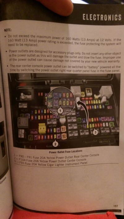

You can accomplish this by moving a couple of fuses around in the fuse box as stated in the owners manual.
Thanks, but, I'm not really all that interested in the rear outlet. I'm more concerned with the front. Any mods for that one?

I think it was the second post here you take the fuse that goes to that outlet and move it in the same place to the other prong. Switches it from ignition on to always on.
Maybe I'm reading it wrong, but, the instructions state... "rear center console power outlet", not the front.

You are correct. I thought the front one was selectable also. My apologies.
