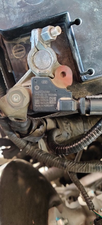

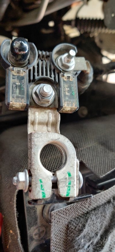

None of those look like my fuses?
The fuses I see at the link don't look like this. Picture 1 is on the + terminal, second is on the - terminal. (Flipped images to be able to read the numbers)3c60dcb379dc6fe6feb323d6a57efa4d.jpg34d7139dbefce6b93ad2800354729f97.jpg

Those are different fuses, it's an all in one assembly. If the fuse is good, don't worry about changing it.
Part of that IBS does look discolored. Just loosen the bolt that holds the IBS on the battery terminal, it will break if you try to completely removed it.
