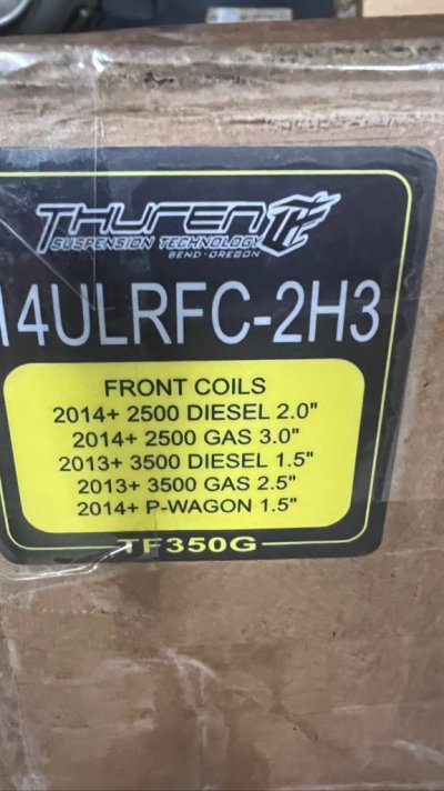

Just looking to level the front.. don't want to mess with the rear except maybe shocks.
Yep, like quickshifter said. Just order up the thuren 1.5” front coils and then his front and rear shock package. Front track bar is not mandatory.
