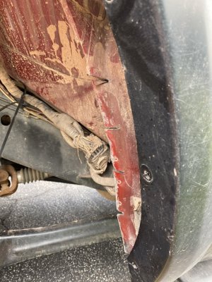

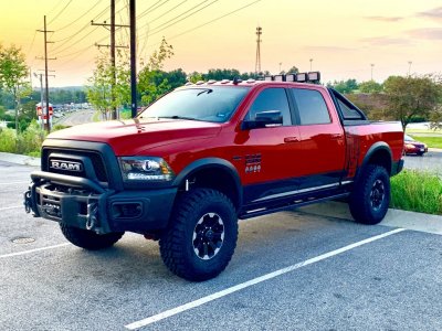

Brand: Procomp X-Treme MT2
Rubbing: Yes, on splash guard (cut up and zip tied back) and pinch weld when flexed (hammered flat)
MPG: 7-9, city, 12-14 hwy
Off road performance: Phenomenal
Wet performance: No complaints
Highway comfort: Soft on the road, minimal road noise
Snow/Ice: Yet unknown
Lift or level Required: Did at same time as Thuren lift, so unknown
Tread life: Got a sidewall cut at 20k miles and I was probably halfway through them, so I replaced all 4
PSI: 45 front/40 rear

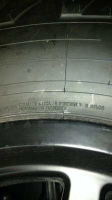

I know this is an old post but are you positive the AT3 in 35/12.5-17 is only a 2 ply sidewall? Seems odd that an e rated tire would be 2ply when the C rated at3 in 35/11.5-17 is 3 ply. 314B33EA-620A-4447-8085-AE5DCCDDDAA8.jpeg

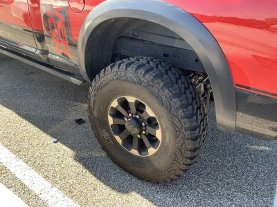

Brand:Toyo r/t
rubbing:no
MPG:12
Off road performance:great
Wet performance:great
Highway comfort:good
Snow/Ice:n/a
Lift or level Required:no
Tread life:unknown
PSI:55
Originally wanted Nitto Ridge Grapplers or Toyo at3 but the virus had those on back order. My tire guy really liked these and I’m surprised how quite they are on the highway. Just as quite as the original Duratracs. I am down 1.5 mpg with the 35 over 33 but completely expected that. If I get good tread life, I will stick with these again.

I know this is an old post but are you positive the AT3 in 35/12.5-17 is only a 2 ply sidewall? Seems odd that an e rated tire would be 2ply when the C rated at3 in 35/11.5-17 is 3 ply. View attachment 227617
My son ran the Toyo AT2 Extreme 285 75R18. He just purchased the Toyo AT3 of the same size and he sent me a photo of the Extremes being a 3 ply. His new ones are 3 ply too. So a 35 12.50R17 AT3 just might be a 3 ply too. Don't know for certain.
