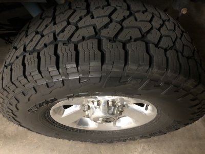

Hey guys I am sitting in my local 4wd parts store and I notice the new tire made by falken for them under there 4wp brand. Has any one heard good or bad about them. Looks like a beefy tire. Thanks

I have not heard anything about them. If they are indeed made by Falken I wouldnt hesitate to try them. They are 3 ply sidewall.

Yeah I can't say I've heard anything about their 4WP tires, good or bad.
I can't speak to Falken's quality as I've never run them on any of my vehicles.
I do know another PW owner out here that has the AT3's and swears by them though.

There are a bunch of us. They are great tires.
