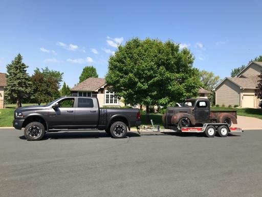

I'm working on a 41 Dodge truck. I wanted all Mopar so i did a 98' Dakota swap. It is a regular cab short box with the 5.2 v8. I had to move the engine back 6" to get enough room for a rad. Wheel base was 4" shorter and i took it out of the bed length.
