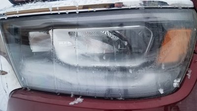

They are ordering new ones now. Heres what they look like at this point (the frost is inside not out). It was way worse earlier, this is after running and driving with lights on for about an hour which does drop some if the moisture. In the morning they are about 75% frosted over.
