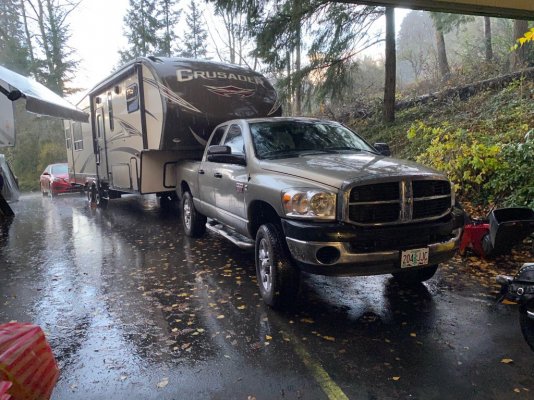

Can you post a picture?

Hi Everyone, Thanks, for the helpful replies. I didn't know that 5'ers usually tow with 20"ers. also the softer ride (when not towing) would be appreciated by the wife. Recently towed a smaller trailer about 800 miles and did notice the 20's towed really well. Most of my driving is local, so I will go with the 17"s I bought used and keep the 20's for towing, which isn't often. Getting Old and its a pain to get everything ready to go. Attaching a photo of the rig. I really like the idea of No DEF in '09 and no DEQ either. As you can see Momma with short legs has to ahve a step to get in. I have been thinking about an electric side rail, but they only drop about 7".
