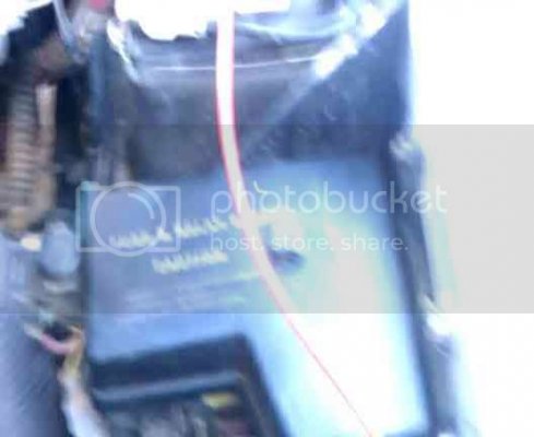

i had a video of my night visions. how i installed it. not sure if itll help. was installed just showing how i did it.
saw the video, My relay feeds the left bulb, the left ballast and the connecting harness for the right side. that harness connects too the ballast on the right side. and the resistor. I'm missing something, Or something isn't right.. I have both of the three pin connectors hooked up, Yours is pretty close too my set up, Did it work? Ya kinda signed off with a ''hope it works'' phrase.lol.

No I still have just hih beams. I had too hook up both oem's for even that too work. Kinda at a loss now. The video isn't much help I'm afraid. It shows the three pin adaptor that I do not have.
