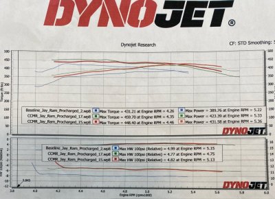

Does anyone else have a procharger on their hemi 5.7 ?
I had a custom dyno tune (91 octane daily driver) performed this week as the "canned" tune was not very good, going back Monday to get the cats gutted and retuned. After more research I am worried about the cats melting long term. I am also having the shop check to see if the crank was pinned as I suspect the original installer skipped that step. I was reading the installation manual and everything was checked off, except the pinning of the crank. I already discovered that they left the original plugs in, I replaced them with cooler plugs and tightened the gap.
Curious what sort of numbers others are getting and tips ? I got 390 rwhp after I replaced the plugs and 430 rwhp after the custom tune. Night and day (drive-ability) with the custom tune compared to the "canned" one.

You might have some belt slip. Number seem low even for a procharger.

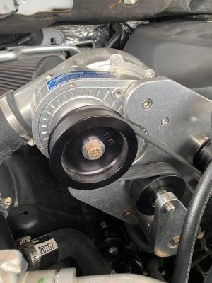

What is your boost psi?
What size procharger pulley?

I just got off the phone line with Procharger. My kit has the correct pulley but due to elevation it is only producing 5 ish pounds of boost. In the theory I should drop the pulley to a 3.5 or 3.45 to get the Procharger producing the proper boost. The kit was designed for 7 pounds, hence why I am getting such low numbers. The original owner installed the kit so I never paid for it, personally I would not have spent this kind of money to pick up 390 rwhp (with the canned tune).

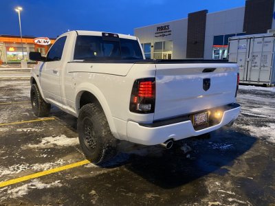

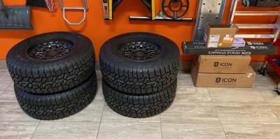

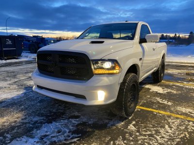

I finally got the Icon 2.5 inch lift kit installed with upper control arms, aligned. I was not happy with my grill mods so I changed the inserts again. Pretty much done now. Smaller blower pulley and fuel pump on order, I'll get that installed and then a re dyno for 94 octane. Prob get a buff job and some new 3m as I suspect my tires are going to ****** my paint. It rides soooo much nicer now, hardly feel the bumps. Overall I am happy, the truck was dog ugly when I bought it, not sure if I could turn it around or not. If anyone is looking I have the take off rims and tires (300kms) and the complete lowering kit with front struts and upper control arms (4wd).
