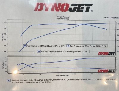

I had a 3.5 pulley & belt installed and a 400 lph fuel pump. Redyno'd with 94 octane and the lift kit. They could only go 4th gear because of the tire size. There was a hot start issue that they were able to resolve as well. 450 rwhp with a safe tune.

Those are pretty good numbers for a soft tune-up.The little truck is a bit of a sleeper,lol.

Not bad! How much boost were you running?
You can see the boost charted at the bottom rh of the graph, about 7 psi. Previous to the pulley change it was around 5 psi. The ProCharger kit was supposed to produce 7 psi hence why I changed the pulley to get me there. I guess the lesson with superchargers is you still need to tune and possibly change the pulley... after install.
