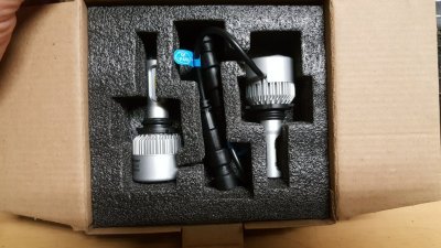

So I started thinking.. I really don't want to pull everything apart and just do low beams. Might as well do highs at the same time! And we'll, then there's fogs! Might as well do them now also. I didn't want to want to just buy everything off of Amazon and not spend some $$ locally if possible. We have a truck/jeep shop just down the road (Firewire) so I stopped in to see what they had to offer. A buddy of mine uses them for his personal Ram and company semis and has been pleased. Worth a shot. I grabbed some leds for highs and fogs and it set me back $200. I'll review them as well once everything is back together. Got some LED back up lights coming from Amazon tomorrow too.
