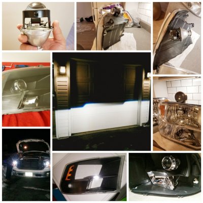

The factory projectors are designed to use halogen bulbs so the output is going to be very limiting. Led/hid bulbs produces more light than the halogen bulbs but the projectors wont really be able to take advantage of that. Hid projectors are engineered specifically for hid bulb's output.
If you wanted led projectors (and there are lots of benefts) then you have to go with say the mled by morimoto. For hid projectors, the mini d2s or mini h7 by morimoto are good choices.
I went with the mini h7v7 and have been very impressed.

There's some guides on here you can follow. You can send it in if you aren't comfortable with it but it really isnt that hard. It takes 6-8hrs to do. You can get the whole kit from trs which includes the harness and everything required. If I had to do it again, I would've went with the minid2s (a bit harder because its bigger) because I perfer non rebased bulbs. You have more options to choose from and the bulb mounts are much better.

I still think factory projectors with a GOOD HID kit like the GTR plug and play are pretty awesome. $300 upgrade gives you tons of good light. Here... let me show you:
23247FB6-797D-4214-9760-8664056F3786.jpegLow beam only.
