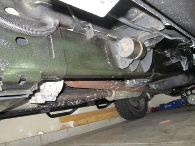

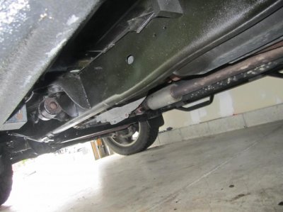

I completely agree, never understand why the manufacturers don't put a nice undercoating on. U would think a 30-40k truck would have a nice undercoating applied to the whole under carriage. I have been using this stuff lately and like it Fluid Film® | Corrosion Preventative, Lubricant and Rust Inhibitor. I just crawl under the truck from time to time and if i see some surface rust or anything, spray it down with the fluid film. It does not wash off either, have had it sprayed on the undercarriage for months. Lot easier and more convenient than doing the proper undercoating crap, plus that stuff can be so damn messy. The fluid film is excellent for an all around lubricant and undercoating, leaves the undercarriage of my truck lookin nice and shiny

u got me thinkin again, just went out and sprayed some more fluid film on lol. Here's a few pics of what it looks like after

Interesting. Does it treat surface rust, or just inhibit future new rust?

I think I'm gonna get some fluid film and give it a try. Seems good
