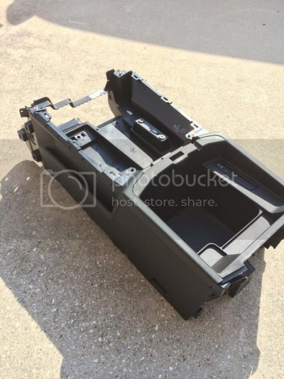

I have been looking into adding a sub to my setup along with amps, 3 way components for the front and new 6x9s in the rear. All of the subs that I see are always for under the seat but has anyone here tried anything else? I am currently working on a sub box to replace my center console. My hope is to make it look as factory as possible. I will post photos of my progress tonight.

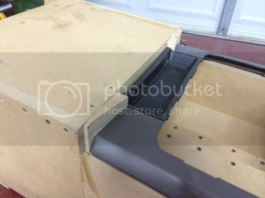

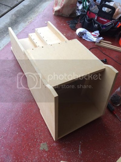

going to start shaving, sanding and shaping the box once all the frame work is complete.
I plan to wrap in in faux leather or vinyl. The back side where the sub is will be painted gray to match the dash panels.

I am running a Alpine Type X 12
Gross volume is just under 2.0 cubic feet. However I have 1" polyfill sheets to line the entire inside. The Port is 12" X 1 " X 24L".
By the way some of my tricks to building a box will remain a secret because they are very unorthodox but i will tell you a awesome trick to determine volume with out over thought math….. cheerios a 12"X12"X24" box a generic cheerios. LOL
Looking into redesigning the path of the port tonight along with the idea of narrowing it up a bit. I am really going for SQ which is going to be hard with a T Shaped Port. Gonna look into turning it into a Y tonight or tomorrow.
