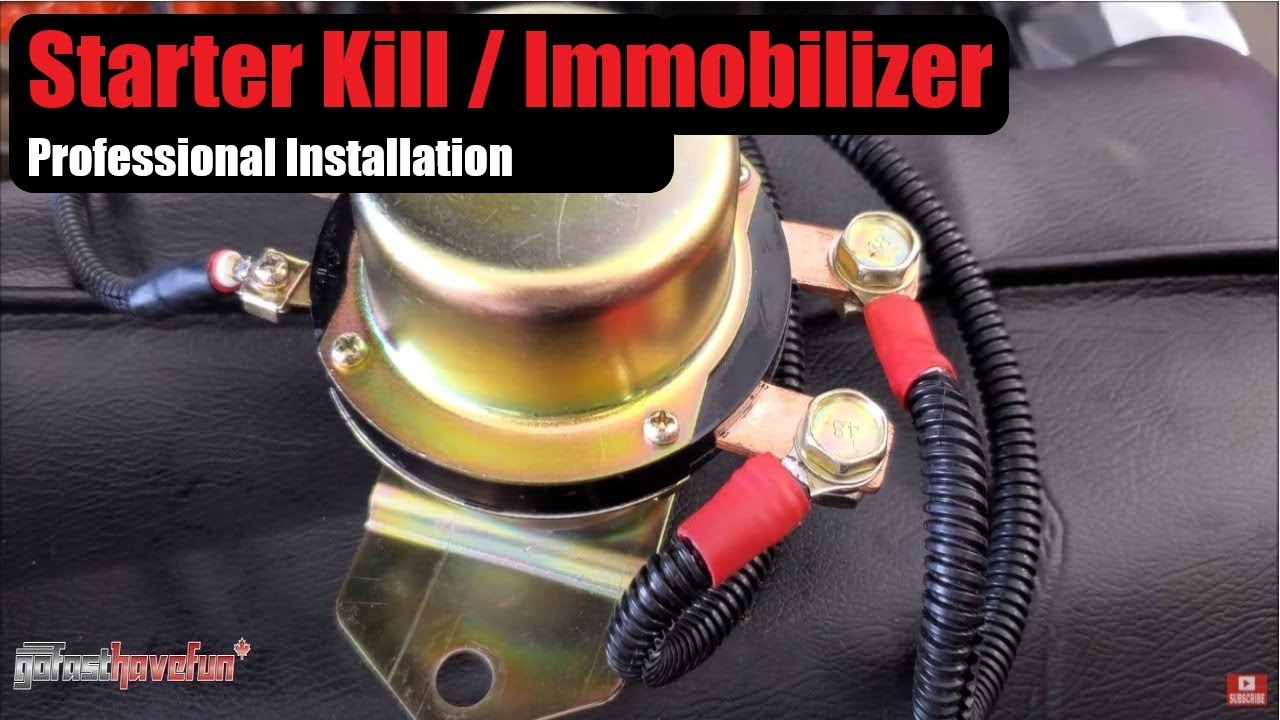

A starter kill switch is a sure fired way to stop/slow down a their from cloning your fob signal and stealing your truck.
Thieves use modules that either extends the signal from the fob or some even clone the signal, so not only can they open the door but also start an drive away.
