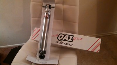

QA1 Shocks - Need help with model #s and parts... ordering today.

Summit. My buddy has an account with them. I just gave him the money and he ordered them. I think he had to put 5k on the account or something like that. Can't remember what he said.
Oh, good deal. Mine are coming from Summit, too.
When you gonna install them??
Please keep in touch with how you do the modifications. Or we can start a thread and share info about it with pics and parts...
I have never installed shocks in a vehicle, much less ones that weren't made for the vehicle they are going in, lol! :emotions122:

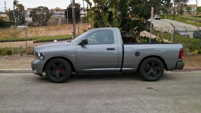

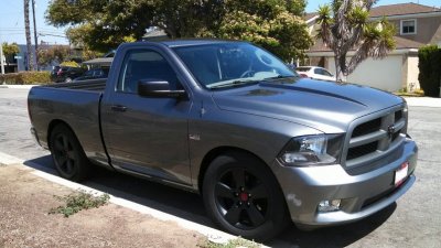

Here's a couple pics of my humble little rcsb

Looks good bud! What size tires do you have on there now?

Its the stock express tires and wheels powder coated, uuuhhh... I think they are 275/60/20, but I could be wrong.
I am doing a Street Fighter look so I am staying with higher profile tires.

All the performance goodies you have, and dropping the tire size down a bit. You'll feel a good bit of difference!

I thought about it, maybe just a little. But I would have to drop the truck accordingly, cuz I don't like much wheel well! :)
These tires have 7,200 miles on them so I'll have to smoke through these before anything else...
