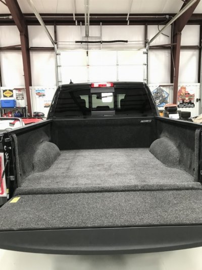

Mines in, I think I’m going to like it. I just used the supplied Velcro, did not put any on the bottom. The lights for me was not quite as simple as it was for previous installers. On my lights, there were rubber insert anchors the screws went into. The bed rug made it impossible to use these inserts are not long enough. The lights only weigh a couple ounces each, I bought some industrial-strength Velcro and ran it lengthwise behind the lights and Velcro’d them to the bed rug, probably stronger than the rubber anchors that was holding them before. So I basically have one small hole the plug fits through and secured the lights with velcro, Can’t even see the Velcro.
