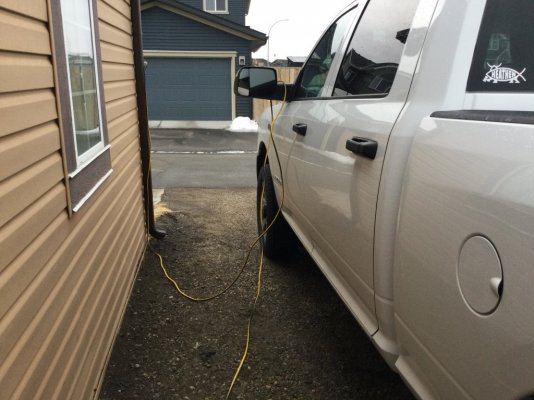

My truck is garaged, but I still plug it in if its below freezing in the garage. Now to remember to unplug it before starting/backing out, that's a different challenge.
Use an extension cord and drape it over the drivers side mirror. I wrapped a microfiber towel over the cord folded in half and shove it in the exterior door handle. Can't open the door without moving it.
Not a bad option, but if you don't tie the cords together or around anything on the truck it should come apart before you hurt anything if you do forget.

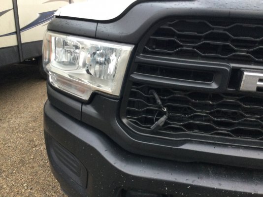

Have your cord stored where you will see it. Drape the cord over the mirror and unplug it from the truck BEFORE you start it. Route the block heater cord on the truck somewhere convenient and easily accessible.
I only plug it in when it’s going to be below -15C.
Remember: If you drive away with the cord still attached to the truck, the only dumb-a$$ you’ll have to blame is yourself.
i use a seatbelt pad on mine,over my drivers mirror.i plug it in in october till late april.central British Columbia.coldest this winter was minus 42 c. also, a battery tender is much cheaper than a new battery.i love how the seat warmers and steering wheel heater come on when i remote start it.
