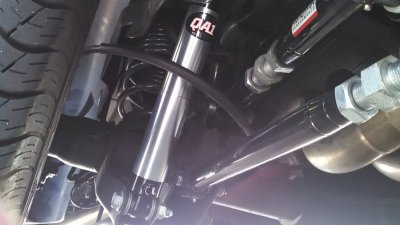

Most guys aren't worrying about it... I added the Spohn upper and lower control arms (re-center the axle and set the pinion angle).

Nice my man I love it. Same kit I was looking at. Was just wondering if it was something I had to worry about right away. Work is slow with the oil and all up here in Alberta. But I do plan on getting that kit. It also stops wheel hop
