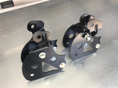

So Wild one, best I can tell the cut version (see pic), is one piece. Essentially bolts to the stock attachment points but you have to cut the top perch off in order to mount them and it does not appear you have to drill alternative holes in the side perches to hold the brackets. Is this correct?
You could tack weld them but it's not required

If you want be careful cutting off the upper mounts,and you can always weld them back on if you want. I bought a another housing and put my rebuilt original housing in storage,to throw back under the truck for when i decide to sell the truck.The replacement housing is the one that got the True Trac and welded on brackets,but i still kept the pieces i cut off just in case i ever need to put them back on.My intentions are to put the original diff back under the truck when it goes down the road,and i'll sell the tricked up diff seperately,and if the new owner of the diff wants the brackets welded back on,it'll be easy enough to do.
You don't have to tack them in place,but it will save you having to stay on top of the bolt maintence. I tacked my Illicit brackets in place when i installed them years ago,and i've never had any issues with the bolts backing off,or the brackets trying to move around. A couple small tack welds is all you need to keep them solidly locked in place.
Roughly what you have to cut off for the Illicit brackets,i'm guessing it won't be much differant for the Inez brackets

Thanks for the visual, this confirms my thoughts.
What feedback do you know about on those that installed the no cut and why they changed to the cut?

Haven't paid much attention,but it seems to have something to do with clearance issues and the suspension bottoming out on the frame or something similiar.

Did a little digging,besides what 6 speed said,apparently the upper locating arm will also bind on the frame,especially if you're using bigger diameter aftermarket locating arms.Apparently it'll go into a bind towards the front locating mount .I asked a couple guys i trust who have switched from the Inez "no cuts" to the "cut" versions,and both said they could see tracks on their bigger diameter aftermarket locating arms where the arms had bottomed out / contacted the frame close to the front upper arms frame mount.I think that might only be a case if you're down towards 4" or slightly more and trying to make the no cut brackets work.I know Ryan (illicit) reconmended only running his later no cuts up to a 3" drop if you had bigger diameter aftermarket locating arms,and i talked to the man on the phone a few times,as it was my idea to add the bolt on plate for the e-brake cable on his Illicit cut brackets. I was also his first big order after he'd developed the first set on Jose's truck,as i bought 4 sets of his brackets and spent a fair bit of time promoting them for him,the only guy who bought more brackets then me was Matt/Moes,lol.
