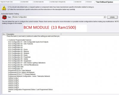

Finally installed the AutoDim Mirror with Auto High Beam Sensor yesterday on my 2013 Truck with the AE tool.
- 911/AutoDim w/AutoHighBeam Mirror: - 68096094AA (Req's Sales Code)
. . . . (AutoDim w/AutoHighBeam Covers: Upper - 1ZA39DX9AA & Lower - 1YW14DX9AC )
Only had 3 settings on mine luckily that I enabled in the following order ...
2013 Ram 1500 SLT CC:
Vehicle Config 3:
Interior EC Mirror Present- Set
(Enabled the AutoDim / Electro Chromatic)
Vehicle Config 1:
Auto High Beam - Set
(Enabled AHB hw)
ECU Config 8: LIN and Misc.:
Smart Beam Present (AHBM): Set
(Enabled feature?)
Really hope that we can find the magic sauce to get this working on the 2014 Trucks like Rick's.

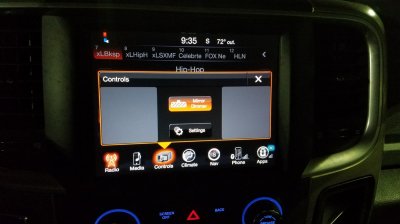

And like STecoD, here's my RA4 /EViC options...
