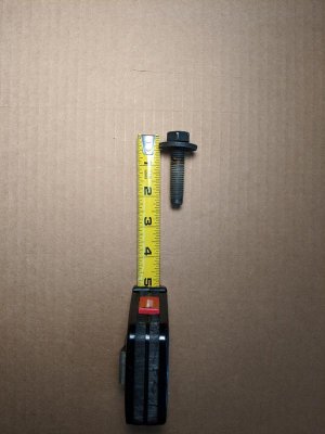

Here's a pic of the rear seat bolt in case anyone wanted to know how long they were. I suppose if you were going to use spacers under the seat bracket instead of cutting off the hooks this pic will be especially useful to you. You have to decide if there's enough bolt there to be comfortable using a 1" spacer on it.
BWL
Embrace the skeptisism
Oct 14, 2017
8,854
8,940
BC Canada
They're M12 1.75 pitch 50mm grade 10.9. When I lifted 3/4" I replaced them with M12 1.75 75mm grade 12.9

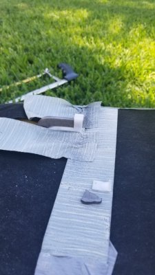

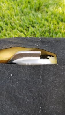

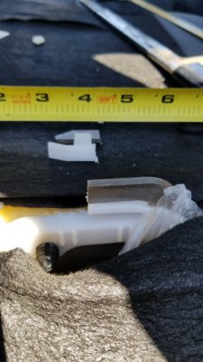

I followed power ram's excellent guide and pics. Much like Bent though i found that 5/8" an inch was nowhere NEAR enough metal. when it was all said i removed more like 1 1/8"++ which i suspect is because i have a 2015 1500 (big horn) and there may have been some small changes to the hardware. for example, my hook had a long smooth taper whereas the photos above showed his coming to a blunt end. no big deal it all worked great, and i was careful to measure with the seat in place before taking off too much metal. Also, side note in case some else is dumb like me. there is a connector for each seat. unplug it. super helpful.
this is a great easy mod, and makes it way easier to do a bunch of crap i need to do (one of my vents leaks, the window seal got folder over in a hurricane and i can't get it fixed with the seat, need to run some cables, yada yada)
check out the pics:
don't forget this connector.
plug end of connector.
first i removed 5/8" waaaay not enough.
after i removed the actual amount of metal needed (something around 1-1/8")
you can see here that i removed past the end of the little bracket about the amount shown.

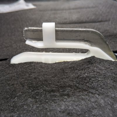

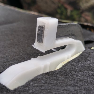

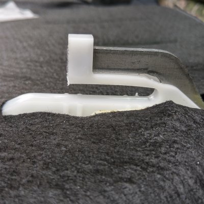

It's interesting that different year trucks have different length seat back brackets/latches.
I believe that cutting the latch to the plastic/nylon collar is sufficient for all.
In my 2016 the cut amounted to 5/8" removed. It seems some trucks bracket's end piece is longer but cutting at the nylon collar works. Here are pics of my latch.
Before cutting
After cutting 5/8" off

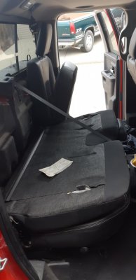

You can throw a memory foam mattress on the fold flat floor. That's what I did for my long drives so I can grab a nap in the back when I get tired.
WY-Dave
Air Force
Jan 22, 2019
5,377
22,862
Cheyenne, WY
2018 2500
6.7 CTD
I have been snowed-in in town and the dog beds are great for that. Looks like monday I will be probably be doing it again
