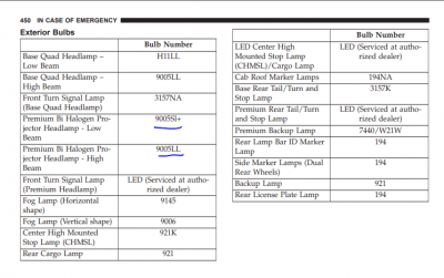

I have a 2016 R/T with the factory projector headlights what bulbs are they? Have read a few threads but see different bulbs listed Thanks

This is what my 2018 with projector style headlights is showing. I would assume the same for the 2016.

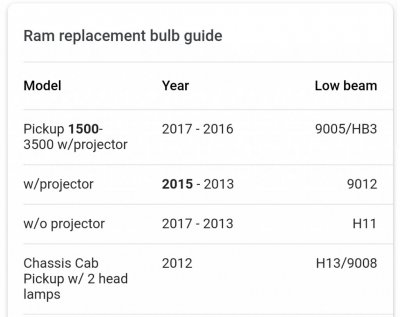

I just pulled this up off a quick search. Clean and easy to read. It's exactly as everyone has confirmed on their years so far.
