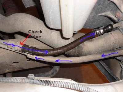

40-50kph is a bit high for a 1-2 shift under "gentle" acceleration. That's more like a 2-3.
Still have the cooler line check valve?

Only did the one line when I pulled it, and it didn't have one. The other side did, but didn't want to wreck the line when it didn't want to spin so I left it alone.
It's possible it's clogged up which can cause a lot of these issues

Heading out now, will report back in about half an hour.

OK, I'm back. Took less than half an hour. Cold fluid yields this: 1-2 @ 30kph, NICE, 2-3 @ 50kph, REAL NICE, OD engages, plenty of smooth power. Get home after going around the block 4 or 5 times, start to back into my space, and the reverse gear doesn't want to engage. It does, but with gas I'm basically idling back. It crawled into my spot.
