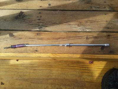

Got 'er done. I did the driver's side first and then turned them on. Even though it's sunny out right now, you could tell a BIG difference vs. the passenger's side. I can't wait until my ride home from work tonight to try them out.
Also, there is no need to remove the plastic radiator cover thingy or the grille. I came up with this idea. It made re-installing that lower bolt that's way down there as easy as could be.
Just a single wrap of electrical tape holding the bolt to the socket.
