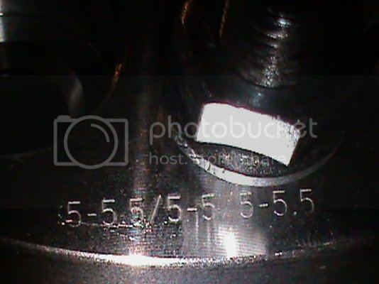

Thanks greg. Pretty ****** turnout on my mod night. One of my hid bulbs came with the halogen part broke off. Then my damn spacers didn't fit. Looks like they were trying to go from a 5/5.5 to a 5.5/5. Does that even make sense? That's what it looks like is imprinted on the spacer. Needless to say I got pissed off and didn't even fool with the hellas

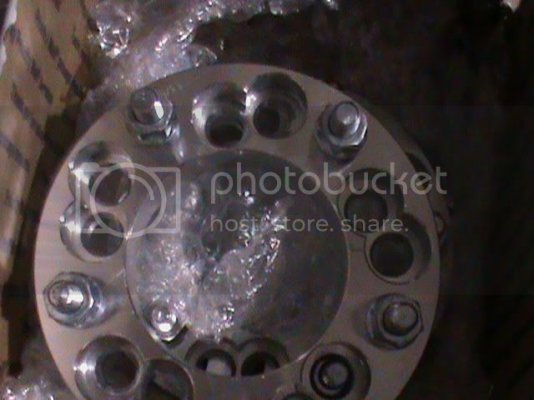

Well, if I understand correctly, it goes from a vehicle with either 5x5 or 5x5.5 to a vehicle with 5x5.5. The pieces I got are double-drilled. My studs were longer then the spacer was thick, which the ebay listing said might happen and I would have to grind'em down.......
Here's a couple pics...
Heres what is on the spacers

Well, then one of them double drilled sets of holes has to be a 5 on 5.5" pattern so they can be used as a spacer...the other set of holes is an adapter so it can be used as both a spacer and an adapter...
I really dont care to use a regular adapter, more or less a double drilled one...they scare me...I mean look at how much meat is between the double drilles holes there...

I read it the same, 5 to 5.5 adapter or 5.5 to 5.5 1.25" spacer. I assume they fit the rims, but don't fit the hub. One set of holes look like it is the same as the 5.5 studs.
If the studs are on a 5.5" bolt hole circle (BHC) then you should be able to take the spacers and stack them onto each other.

Greg,
Thats how the spacers came, stacked face to face. They fit on the lugs/hub fine. I used the old lugs to bolt down the spacer, then put the rim up. The lug stuck out so far (because the stud is too long) that the rim barely set on the "new studs" enough for the open-end lugs to bite. Im wondering if grinding down the old studs is the answer? Im bout to just say f-it and send'em back and just get the cheapo advanced ones, lol. dammit.

Bear, That is standard practice to have to cut the original studs on the hub. Unless you have a wider spacer. It is even mentioned in the ad.
