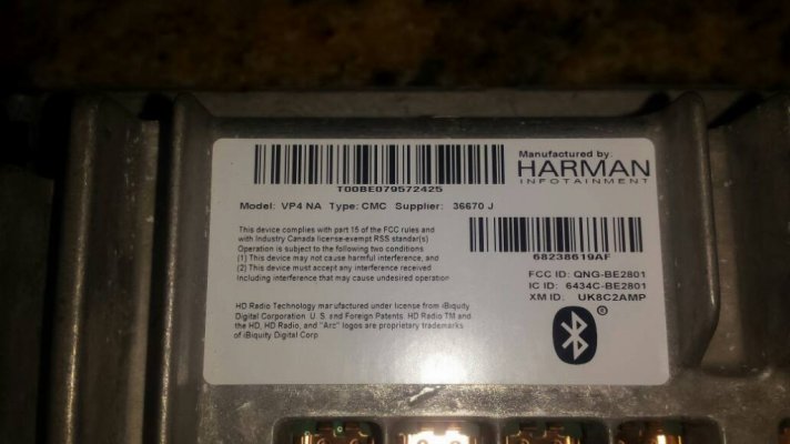

Unless they have a picture of the back of the radio it's tough to tell. On car-part you need to be careful because a lot of Canadian junkyards list stuff there as well. If you get a radio from a Canadian vehicle they have less options than the U.S. version. For example there are different RA4 radios. The U.S. version of the RA4 will have the part# on the back that's VP4NA. The N.A. stands for North America. The Canadian version will say VP4CA. The CA stands for Canada. As far as the junkyards go they don't really notate the difference they just put it down as an RA4 which they both are but there are differences in the radio. What I have done on car-part is actually call them and verify that the back of the radio says VP4NA before I purchase it. This is a picture of the back of the U.S. version RA4 you can see the part# is VP4NA. I've seen a lot of guys find radios and jump at them because they're cheap price and they end up getting a Canadian version or other version radio instead of the US version . So long story short. If you do not care about having the Nav the radio you want is the RA3 part number VP3NA. If you want Nav it's an RA4 the part# is VP4NA. Most people opt for the VP4NA because it has other features such as HD Radio real-time traffic,Travel Link ect.2c313e785e280d058f47d4888870ceb0.jpg

I'm definitely shooting for the NAV version. I guess I'll just have to start calling around once I get the cash
