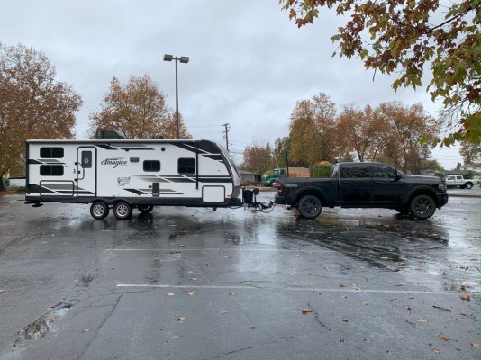

Actually, that's my setup. I have 2019 RAM2500 Diesel + Imagine 2400BH. I used to tow this trailer with a large SUV, but the SUV was struggling when going uphill and also had hard time controlling the trailer. I could definitely feel the trailer. We decided to upgrade our TV one day when we had to hit the emergency brake due to sudden heavy traffic. It was really dangerous. After changing my TV to RAM2500, it's been really easy and stable. Even when we had to hit the emergency brake, the TV handled the situation really well. The TV's curb weight is about 8,000 lbs, even heavier than the trailer. It might be a overkill, but there is no such too much safety. Anyway, I think either Gas or Diesel should do just fine for your trailer, but if you want more power for uphill and overtaking, go with Diesel. No stress what so ever. Otherwise, Gas should just do every task just fine.
Good looking setup!
We tow ours with a Dodge Durango R/T Tow N Go. While it's comfortable towing, we usually take mostly country roads etc... on the highway you can definitely tell it's there even for a larger SUV. The shorter wheel base really does become a factor at higher speeds. While I haven't encountered an unsafe situation, driving for hours and hours as part of future plans has the potential to be exhausting. I think that's why we are looking at the RAM 2500, having way more truck than trailer just seems like it would make long trips much more enjoyable.
We have no real interest in changing the size or the trailer as it then severely limits the parks we can get into.
Do you have rear air in your 2500?
