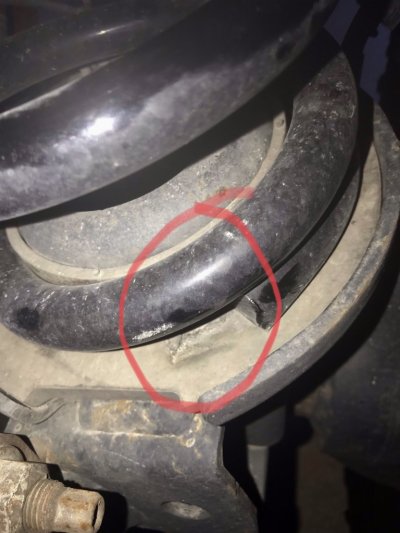

I haven’t yet. I’m definitely going to try. I did take a look tonight and noticed this. Doesn’t seem right. f9849974bfc35f6b54c4c46f0b2028c1.jpg

rsz_1daves_truck.jpg I have the same kit on my 2018 2500 Tradesman with NO issues. I even have larger wheels & tires on From the pictures it appears that the spring is not seated in the exact same position that he oem was. This should be corrected as on side could not be higher then the other. The steering wheel fix was easy with mine. Just remove airbag and nut that hold steering wheel on and adjust reassemble.

The cups on for the springs on these trucks sit at an angle. Def make sure they’re seated correctly. The driveline needing corrected would cause a shudder at take off. And is cured by shims. Did tires get road force balanced? I have vibrations at 70mph plus. Running thuren kit shocks, springs, trackbars and no sway bar. But my vibrtarion I’m certain is my tires as they’re almost chunked out lol. I’m betting tires
