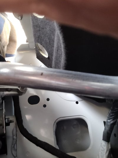

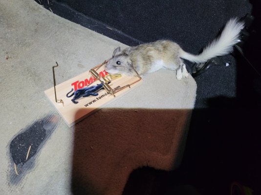

Just returned from my last camping/fishing trip up the lake. Kootenay Lake, that is. But this time I brought home a hitchhiker. As I was packing up I noticed popcorn like bits on the driver side floor. Close examination showed chewed up insulation. Popping the hood I found a 3" sq. section of firewall had been gnawed at. I hoped he was gone but when I got home he poked his nose out at me. A goodly sized pack rat. Had the hood open and ran the engine and heat at full blast to try to drive him out. When I looked at the engine compartment I saw him run into one of the square holes just ahead of the firewall and just aft of the wheel well on the passenger side. It seems he was easily accessing the interior from there. Has anyone any diagrams of these accesses? I am thinking of screening over any such openings like these for future prevention of this catastrophe. A quick trip to the hardware store for a couple of rat traps baited with peanut butter and set on the driver side floor produced results in an hour or two. Unfortunately it had given him enough time to chew the aforementioned insulation plus a dash speaker wire and the wifi antenna cable. The cable was the big pain as Mopar is on strike but I finally found one at a wreckers many miles from here. First attack on my brand new 4 mounth old Ram 1500 Classic.

Back home now (Creston). No rats or mice here. A million cats.

So just pulled the cab filter. Rat turds and pissed on. He was lying on top of the perforated filter compartment where he could just let go whenever he wanted. Looking up towards the passenger side engine bay/ wheel well I can see light so there is easy access in thru there at least. May just go ahead and screen all the holes I can find with a light use of caulk as glue.

I was lucky. Short term residency. And the bugger conveniently used the cab filter as a cat box. I can't see using mothballs in there and using the heater at the same time. The Bounce dryer sheets sounds like a plan. But, for those who have had a late model 1500 grill off I was hoping someone could tell me whether the square tube sort of sub frame that contains the cab access hole and runs horizontally above the wheel well to the front, is sealed off at the front or open. It might be open to bring in direct clean air to the cab also. And that may mean I'll be pulling the grill and possibly headlights to cover those too.
Some of the air access openings are to allow air movement to prevent moisture build up in hard-to-get-to body areas.
