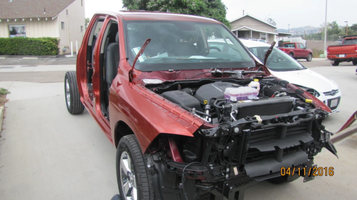

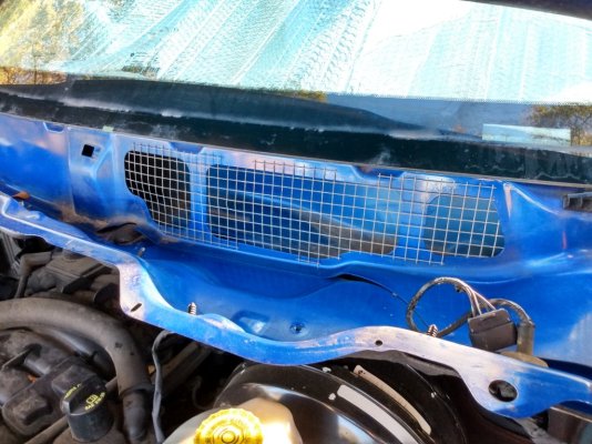

I have mouse-proofed our cars in the same way, 3/8 hardware cloth over the cowl area air intakes. It has worked well, though the ram has multiple holes. After seeing your pictures, I'm not sure I got them all.
