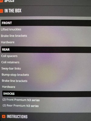

The shocks that come with that kit are rear only.......the side to side movements should feel same as stock
I clicked on the link and saw front and rear, must be a generic picture. I wrote the first thing that popped into my head. A quick scan of the description didnt mention diesel and there is quite a difference. I have guys send me links to the wrong kits on a daily basis, mainly the 2500's and 250's. I install a lot of lifts and never had one sloppy pre alignment something doesnt add up.

JB1.......you are corect!.................I purchased & installed this kit on my truck in 2018 & at that time it didn't come with front shocks??

I just used the stock shocks.....truck only had 700mi on it when I did the lift
After the lift, with original tires and wheels it rode just like stock, went straight down the road with no issues
