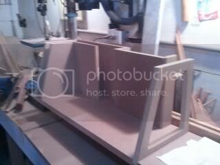

After planning for awhile I decided to put two 10" kicker CVR's in a custom built ported box, powered by a RF R1001.1d. The airspace requirements were a little tough to meet without sacrificing space. If my measurements are right the seats should still slide and lean all the way back without interfering with the speakers or ports.
View of the passengers inside of the box, with the center support all cutout to equalize pressure in both sides.
Every interior corner is rounded to prevent any inferior port noise, and out just looks good.
The top, datos and rabbits all cut and ready to put together.
The back, with a cutout for the seatbelt built in.
View from the front, only thing missing is the faceplate, being glued together and some final sanding, and carpet before the speakers can be installed and put in the truck
Any input is well accepted, thanks for checking it out.
BTW, first thread with pictures, hopefully it's right, if not, I'll figure out.

be a little much power wise on two CVR 10's...whats tuning and SSF set at?
