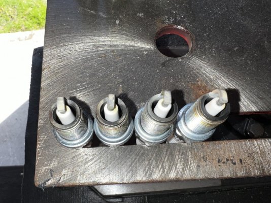

She started burning a tad more fuel lately and I got a whiff of fuel a few times while she was warming up I will do screen shot tomorrow of it running while on my scanner and maybe you might see something I am not very good on the values or understanding what they mean
If the weather is cooler than normal, that would explain more fuel being burned and the stronger smell of fuel. Also if the gas stations are selling winter blend fuel higher consumption rates is also typical.

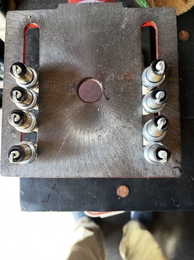

i'm just curious, the 2 plugs that are furthest right
1 in the upper image, 1 in the lower image
Are the Gaps the same on those, as the other 6 ?

Might be running a bit rich on one/two cylinders?

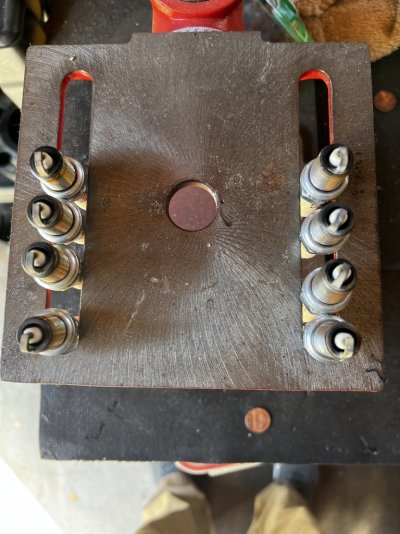

The ones on the left are the passenger side with the as if you were sitting in the cab looking forward with the rear plug closest to the firewall

If the weather/engine is cold the computer will send more gas to the cylinders. Also when the engine is cold hook up the scan tool and with the key on engine off look at the temp sensor reading(s). See if that coincides with the ambient temp. The temp sensor and ambient temp will not be exact but should be close or reasonably close. If the temp sensor is bad the sensor will read zero or it will have really high reading. Those plugs look good by the way
