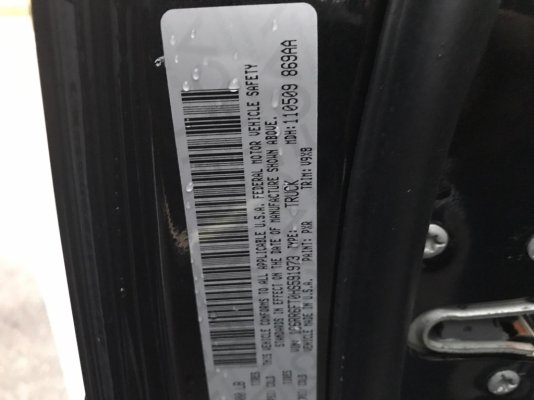

Benny is there a part before the adapter duct 55056931ab? I did not originally have rear air in my 2017 Ram Express. The console I have does have the duct work. What gets the air from the AC box to the duct? Can it be done in my model. If not do the make a rear cover black with out air vent holes. Attached is my vin for ref.

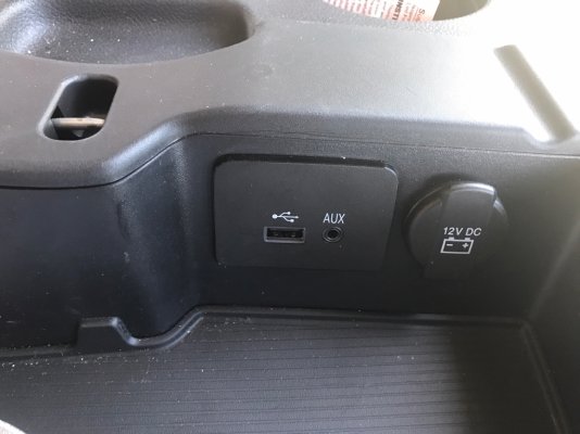

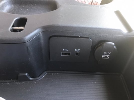

Benny I have a couple more needed parts. When my console came in it was a dark grey and was damaged. I also realized that the rear air wont work with my application without cutting the air box in some way. So I have decided to do away with the air vents in back. I need the black blanking plates or a different back cover without vents. I also am looking for both sides for the console to match the extension wings you sent me. On the drivers side there is also some sort of plate cut out. What is that for? I would like to get that part. Are there rear screw hole covers to that cover the screws that go in to the bracket?
My jump seat had a USB / aux plug in it. My center does not. Any way that you can think of to add it?
Maybe the picture attached custom into the access panel I asked about in the above? Maybe adding the new tray under the armrest? I would also need the wiring if not included to make the connection to location under seat?

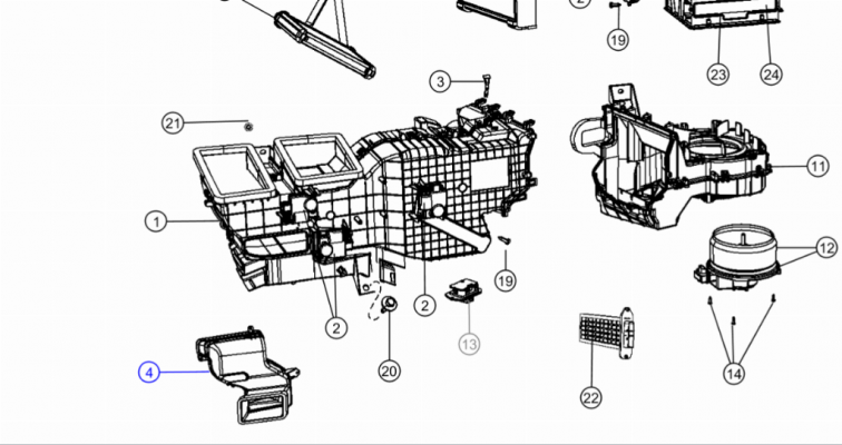

When you say top left in the photo is it in the red area or blue area? Im sorry I dont see what the problem is

I have 3 exits coming off the lower AC box look like the blow across the floor. I believe the red would be a punch out type attachment. But to hit that area you would travel back about one once turn
Jkieffer
Jkieffer
Jun 1, 2017
319
128
Travel back one inch go up 2 to 3 inch. It would be an s shaped piece that's why I believe it would be easier to have the black blank out plates on the rear panel. What type of screws attach the console to the rear bracket.? The one I have do not have a color or any head covers and stick out like a sore thumb. I have the older style cup holder for the console and need the rubber piece for in front maybe part 1vm56dx9ab

I did find another duct listed with the HVAC unit shown as #4 here
This part # is 68049979AA
The forward mat part number is 1VM56DX9AB

That looks like that would be it!!!
