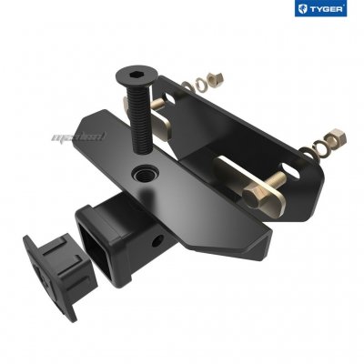

You truck most likely has ahitch like this installed. 2 bikes into the cross member, and then one large one up through the step bumper where you would normally mount a hitch ball if not using a receiver hitch.
Sent from my Pixel 5 using Tapatalk
That should be exactly what he has. It’s what I added to my 1500 when I had it and it was just as op described.

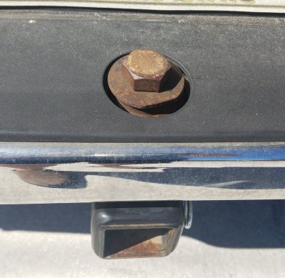

Here is the picture of the rear bumper and the bolt sticking up. I think that CanadianKodiak70 is correct. I will check to confirm. Perhaps if I shorten the bolt a little, it will be flush with the top of the bumper.
Shortening the bolt won't lower the height it stick above the bumper as it tightens to the bumper.
If memory serves me correctly that bolt needs to be torqued to 275 ft/lbs.
Somewhere around there for sure. I remember it was a ridiculous number haha

It does look a little high to me, I’d make sure it’s tight,if there’s any play in it it will tear out that hole in the receiver. Had it happen, it sucks.
