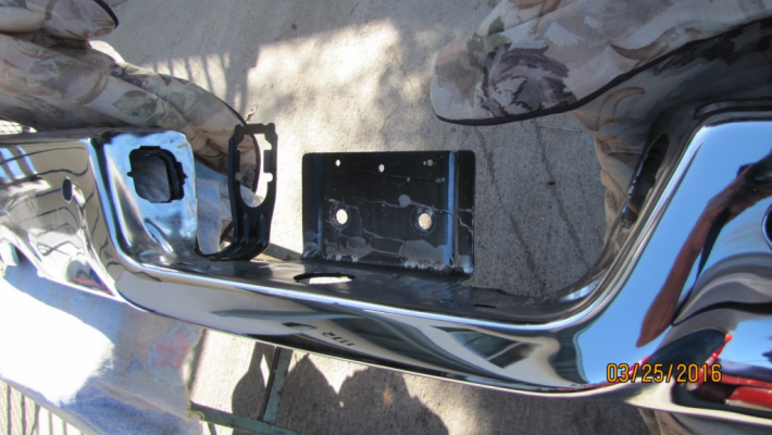

Hopefully someone else chimes in - I don't know if it fits, I think the 4\7-way trailer connector on the 2500 is to the right of the license plate instead of on the left on the 1500. Not sure if that's a show stopper. But if it doesn't fit and you are not going to get it, let me know where it is? I need a chrome rear bumper for my 3500.

^^^ what he said
The bumpers are interchangeable but you might have to move the wiring harness as the trailer plugs are on opposite sides.

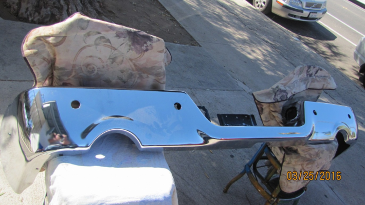

Let us know what you paid for the rear bumper, please
i have one out here on the West Coast, i pulled it off my Ram when it had maybe 500 miles on it
It will be a local sale, when it is time

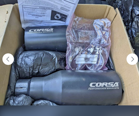

Pumped at those tips. $150 for the pair local, 1 month old.

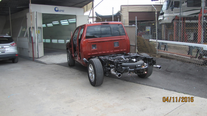

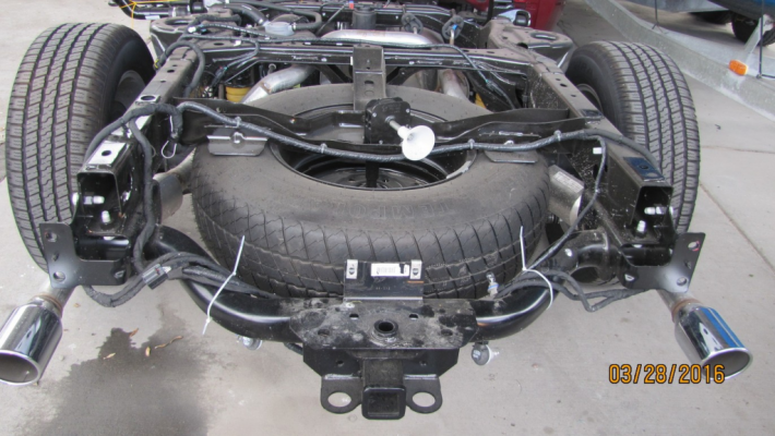

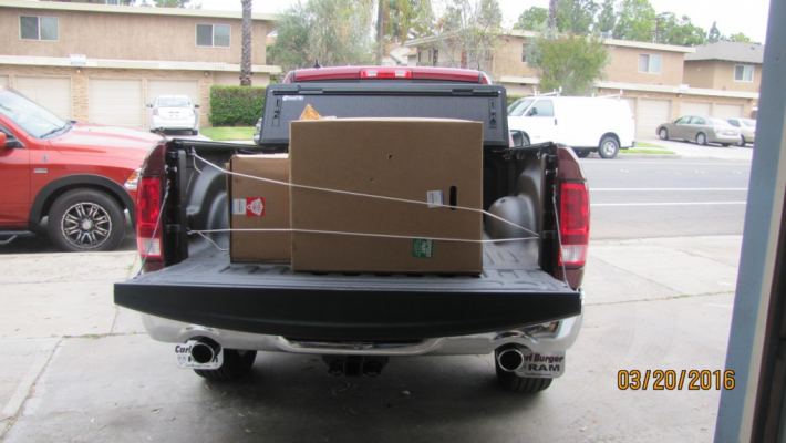

Even though my Ram is an Eco-diesel
It runs duals at the rear axle, just like the Gas powered Rams
To bad that the shop left the spare in place, but it was about to roll into the paint booth & the whole frame in back of the cab was going to be covered.
It looks like Resonators & shielded exhaust under the frame, between the spare tire & mounted tires on the rear axle

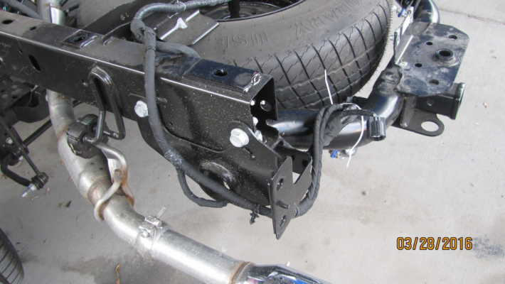

Also for those that are curious, if you do a Zone 1.5” body lift, you can see in the pic what has to get trimmed on the rear bumper in the pic above. The underside of the step on the rear bumper has to clear the top plate of the hitch.
