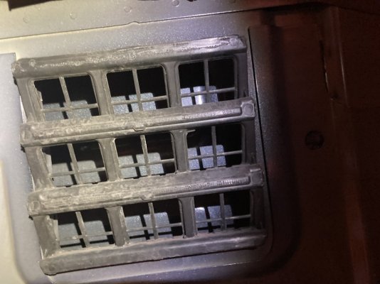

This is between the cab and box on my 2014 1500 5.7 Outdoorsman. Never noticed it before. I must be slow. Who would like to explain this to me.

I assume that is behind the back seat below rear window !?
There are 2 and they are vents !
And the look like this
Cab vents. They allow the air pressure to equalize rapidly when closing doors.

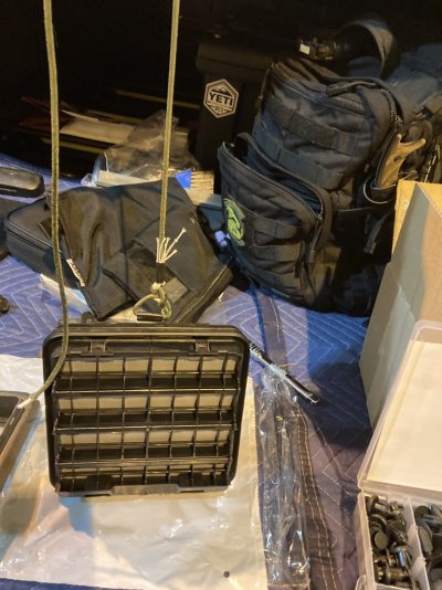

Replaced mine not to long ago, I have a 15’ & most of the flaps were missing, the ones left were dry rotted.
The hardest part is removing the rear seat but after that was easier than I expected.
What made you replace these? Other than our OCD? :laughing1:

I would occasionally find the carpet damp, I don’t have a rear window & my 3rd brake light showed no evidence of leaking.
As bad as they were, I would have thought it would’ve leaked a lot more, no leaks after the new vents.

Same here a couple years ago. Most of the flaps were missing on mine and the carpet was really damp. Replaced the vents and no more soggy carpet.

Geno’s garage has just added these to their latest inventory.
The good news is these are listed for and the pics show chassis cab vents .
These are much better construction compared to what is currently being installed from the factory.
I found these on my truck and was able to wash and reinstall, all the flaps looked new, and there is more of a covering protecting them.
This is a superior product,like apples to oranges imo.
