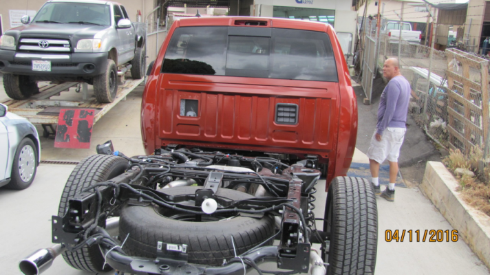

Looks like this thread is a mix of Generational Dodge Rams already
I guess that i can't mess it up much more
This is a 2016 Gen 4 Ram Eco Diesel
