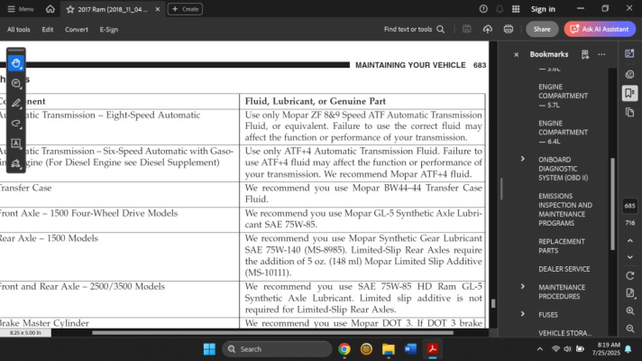

Owners manaul ( printed in 2016) said 75w140
Owners manual online said 75w90
Dodge checked with my vin and said 75w90
Who is right ? I bought both and i guess ill see the viscosity when i dump it. You can tell one is more liquidly than the other.
Also, I believe that 140 you have, MS-8985 requires a LS additive for the rear. MS-10111
