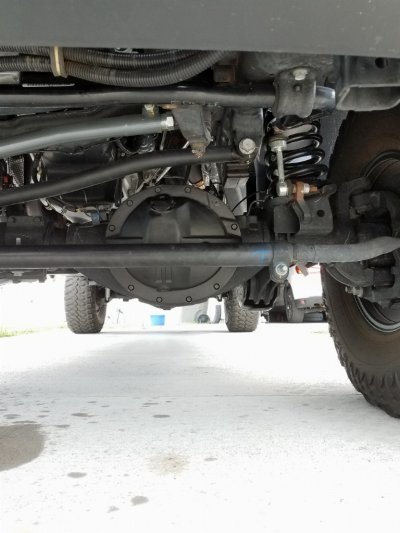

loves me some nodular iron so i put my own touch on some aev stuff. arp hardware and black paint. nothing fancy
