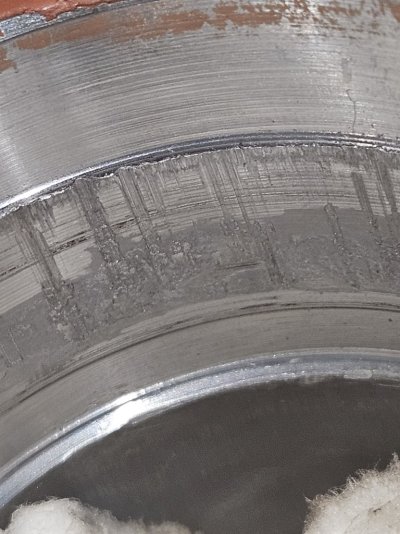

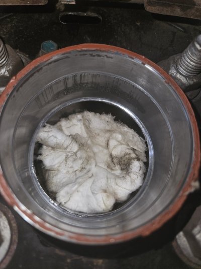

Also, depending upon your mileage, might want to consider new axle bearings as well. Only around $80 shipped for both OE bearings @RockAuto.
I replaced my seals and bearings at 192k miles20240831_154651.jpg and found my driver side bearing was semi-stuck in the bore of the axle tube.
I'm not sure what caused this, but glad I got it out and my axle tube wasn't damaged further.
