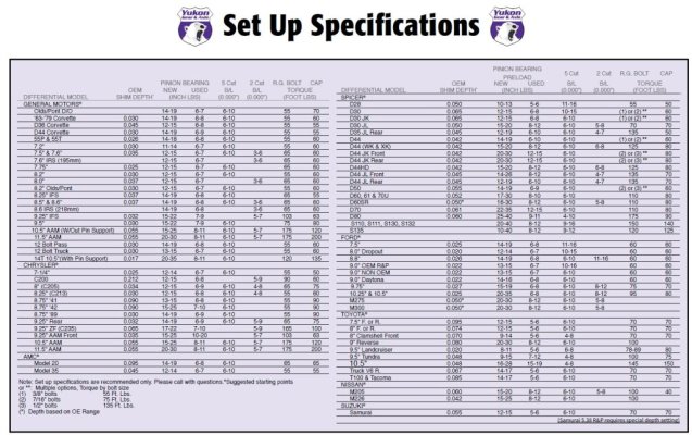

Inquired with Yukon their response was to torque the side adjusters to 100-150ft lbs.
They also stated that there’s no problem tossing the race to housing shim, that on their kits all the shims are bearing to pinion.

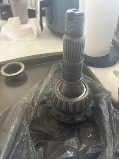

Got the new tool, it zapped off the bearings off stupid easy!
Also my pinion had 0 shims under the pinion bearing so I should be good to add the same thickness as what was behind the race.

30°F pinion, 200° F bearing, old bearing as spacer, hammer… right on with 0.065” of shims.

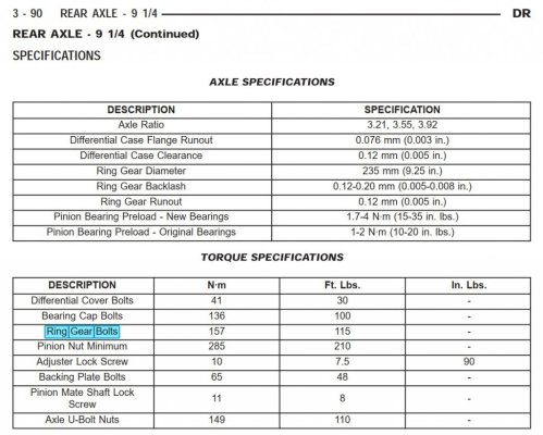

Just go buy the specs in the Yukon book. and Initial torque of 210ftlbs is just the minimum you need then you keep torquing down until you get your pinion pre-load.

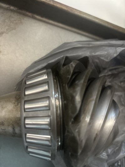

I was astonished by how little damage to the bearing rollers correlated to such diff whine. I was expecting significantly worse damage to bearings / races.
