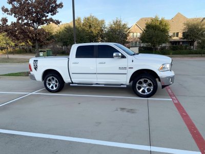

I noticed this on my 2017 1500 Laramie. I thought maybe a previous owner had exceed the payload enough or enough times that it did some permanent adjustment to the suspension. When my truck is parked in the right spot it almost looks like my rear bumper is lower than my front bumper. Can anyone tell me the best way to take measurements and see exactly where the truck bed sits and what the height SHOULD be? Am thinking that I definetely need some suspension work or heavier springs. I actually carry two dirt bike on a double motorcycle rack maybe once a month and the truck squats way way down. Truck is 4WD and the rack is made for two bikes so it should carry them. They do stick out of the back of the truck so the payload is way far back. But then I take the bikes off and my optical conclusion see's the bed of the truck angling down. Like it has been bent in the middle between the cab and the bed. I can take a measurement from the top of the bed to the ground, but what is that height supposed to be? Am I looking at worn leaf springs on a 2017 or taxed shocks or what should I be looking at or for? By the way I have a fiberglass top on the back of the truck. That is why the bikes are not carried in the bed.

Sorry I just noticed that someone had replied. Can someone tell me how/where to measure from to confirm this? It may be an optical conclusion but it looks like the point where the bed meets the cab is the pinnacle. Obviously not that dramatic but if you took a straight line from the hood back to the tailgate the point where the bed meets the bulkhead would be the high point. I just want to make sure I don't need new coils or springs. It really does it with the dual bike carrier on the back with a KX250 and KX450 on it. I know it is sticking way out past the bumper but the Lariat 150 4X4 I had previously did not look that way.

Thanks for the suggestions. I will install one of them. I was just wanting to know if there was a surefire way to know if the truck had an issue with being overloaded or some kind of damage before I start to try and chase something and counter a physical problem with the suspension or frame of the truck. Truck is awesome. First Dodge Ram I have ever owned. It just looks kind of "bent". I will get some more pictures.

Compared to a stock truck, looks like it’s your front end that is raised up. May want to check if the previous owner installed a leveling kit or something. Perhaps it can be lowered to adjust the rake.

Yeah, that looks like the front is lifted. Maybe it has coil spring spacers in the front. If it has those, I'd remove them.
