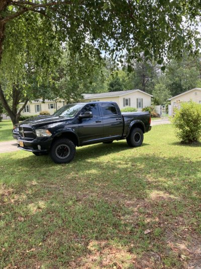

I imagine at 15 your not driving yet, if this will be a project , not needed for getting to school/work just take your time & do lots of research.
I think our trucks look great leveled or lifted but it is important to do it properly. I would use struts to level versus spacers & bigger tires can/ will cause more wear on wheel bearings, brakes & get will lower gas mileage.
Look for people upgrading their trucks selling used parts & wheels/tires, if you are doing the work yourself it could be done on a budget.
Take your time & do all the research you can, double check everything before buying parts to be sure they work for your truck.
Lots of help on this forum, use the search & you’ll find tons of info on most upgrades, good & bad, that will hopefully save expensive mistakes & there is a bunch of knowledgeable members here that have helped me in the past with solid advice.
If buying new be sure to check with the forum vendors first.
Good luck with your truck, be sure to post some pic’s, I’ll be following.
